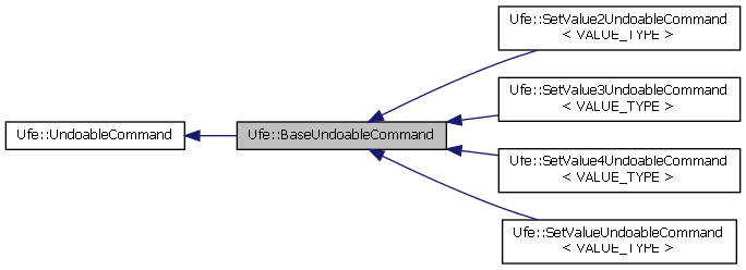

Ufe::BaseUndoableCommand Class Reference
Base class for undoable set operation commands. More...
#include <baseUndoableCommands.h>
Inheritance diagram for Ufe::BaseUndoableCommand:
Collaboration diagram for Ufe::BaseUndoableCommand:

Detailed Description
Definition at line 30 of file baseUndoableCommands.h.
