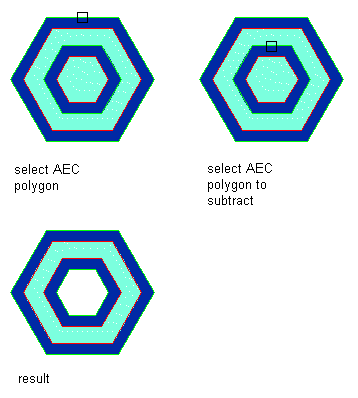

Use this procedure to subtract AEC polygons from one another in order to create a hole in an AEC polygon. This would be useful, for example, for creating a complex pattern for a curtain wall infill.
To perform a subtraction operation, you need to select AEC polygons that intersect one another. You can choose whether to keep the subtracted AEC polygon in the drawing as a separate unit. For example, you may want to keep the AEC polygon if you need to subtract the same shape from other AEC polygons.
You can draw the second AEC polygon within or overlapping the area of the first AEC polygon, or you can draw it in another location and then move it onto the larger AEC polygon.
