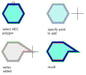

You can add a vertex to an existing AEC polygon to change its shape. A vertex is the location where the edges of the AEC polygon meet.
. Line segments are drawn from the two existing vertices of the AEC Polygon closest to the point that you selected to form the new vertex.
