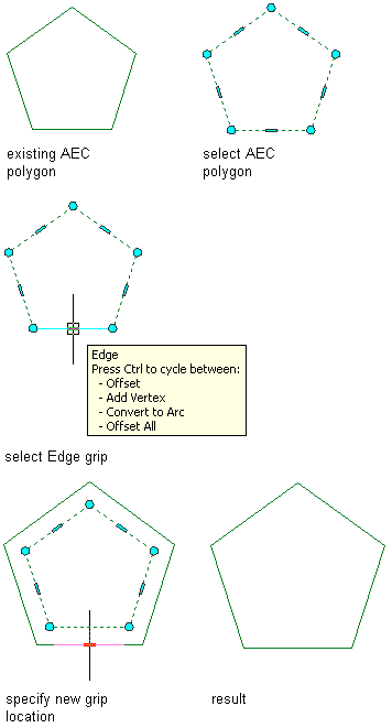

Changing the edge of an AEC polygon.
Viewing the AEC polygon Edge grip tooltip
The Edge grip has four edit modes: Offset, Add Vertex, Convert to Arc, and Offset All. The default mode is Offset, which offsets the selected edge in a direction that is perpendicular to the midpoint of the edge. Depending on the shape of the AEC polygon and the edge you choose to modify, neighboring lines are extended or trimmed, and new lines are added, as necessary.
Offsetting the edge of an AEC polygon using its Edge grip

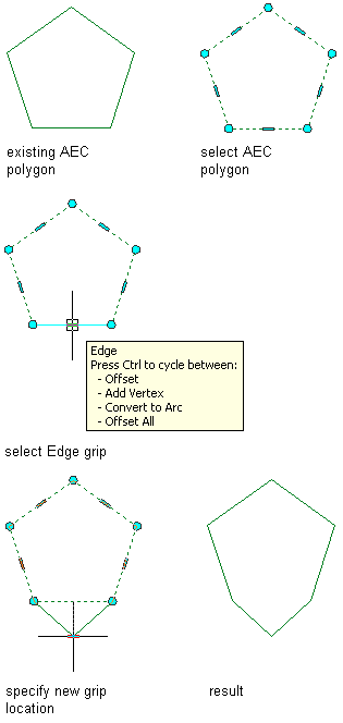

Use the Add Vertex edit mode to add a vertex to the selected edge, and create a new edge. If the selected edge is an arc, the new edge is an arc, as well.
Adding a vertex to the edge of an AEC polygon using its Edge grip

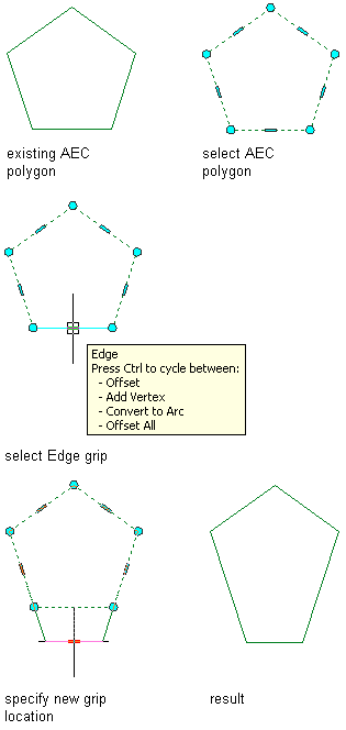

Offset All moves all edges of an AEC polygon at an identical distance. When you drag one edge, all other edges are repositioned accordingly. This option is very useful for regular resizing operations, like scaling an AEC polygon.
Offsetting all the edges of an AEC polygon using its Edge grip
| If you want to… | Then… |
| offset the edge | move the edge to the desired location and click, or enter a value and press ENTER. |
| add a vertex and create an edge | press CTRL to switch to the Add Vertex edit mode. Move the edge to the desired location and click, or enter a value and press ENTER. |

| offset all edges at an identical distance | press CTRL three times to switch to the Offset All edit mode. Move the selected edge to the desired location for all edges and click, or enter a value and press ENTER. |

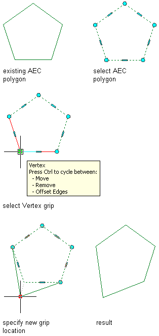

Changing the vertex of an AEC polygon
Viewing the AEC polygon Vertex grip tooltip
The Vertex grip has three edit modes:
Moving the vertex of an AEC polygon using its Vertex grip

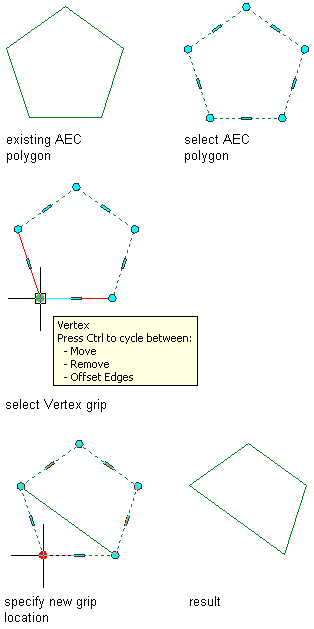

Removing the vertex of an AEC polygon using its Vertex grip

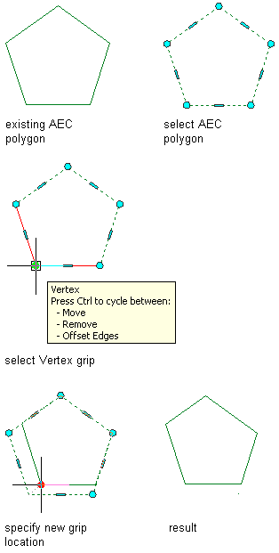

Offsetting the edges of an AEC polygon using its Vertex grip
| move the vertex | move the vertex to the desired location and click; or enter a value, and press ENTER. |
| remove the vertex | press CTRL to switch to the Remove Vertex edit mode, and click to confirm the removal. |
| move the vertex and the adjacent edges | press CTRL twice to switch to the Offset Edges edit mode. Move the vertex to the desired location, and click; or enter a value, and press ENTER. |
