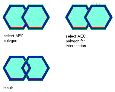

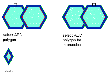

Use this procedure to create a new AEC polygon from the overlapping portion of two intersecting AEC polygons. You can choose whether to retain the original geometry after creating the new intersection AEC polygon.
Intersecting AEC polygons with original geometry erased
Intersecting AEC polygons with original geometry retained
