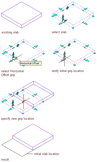

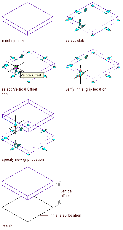

Use this procedure to change the vertical and horizontal offsets of a slab or roof slab object in a 3D isometric view.
The offsets are the vertical and horizontal distances from the insertion point of the slab.
Changing the horizontal offset of a slab using the Horizontal Offset grip
Changing the vertical offset of a slab using the Vertical Offset grip
