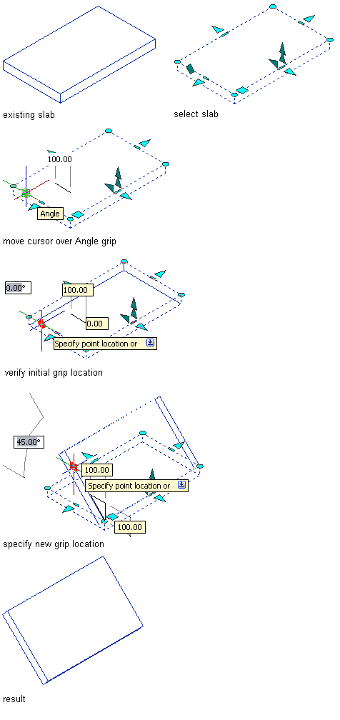

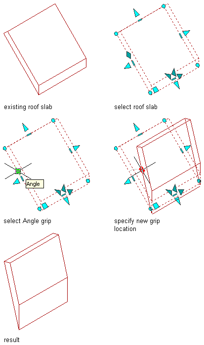

Use this procedure to change the slope of a slab or roof slab in a 3D isometric view. (You can also use the Properties palette to adjust the slope and control the automatic alignment of the fascia).
Using the Angle grip to edit slab slope
Using the Angle grip to edit roof slab slope
| If you want to… | Then… |
| adjust the slope manually | either enter a value, or move the grip until the desired angle is displayed, and then click. |
| adjust the slope by changing the rise of the slab | press Tab until the rise value is highlighted, and then either enter a value, or move the grip until the desired rise is displayed, and then click. |
