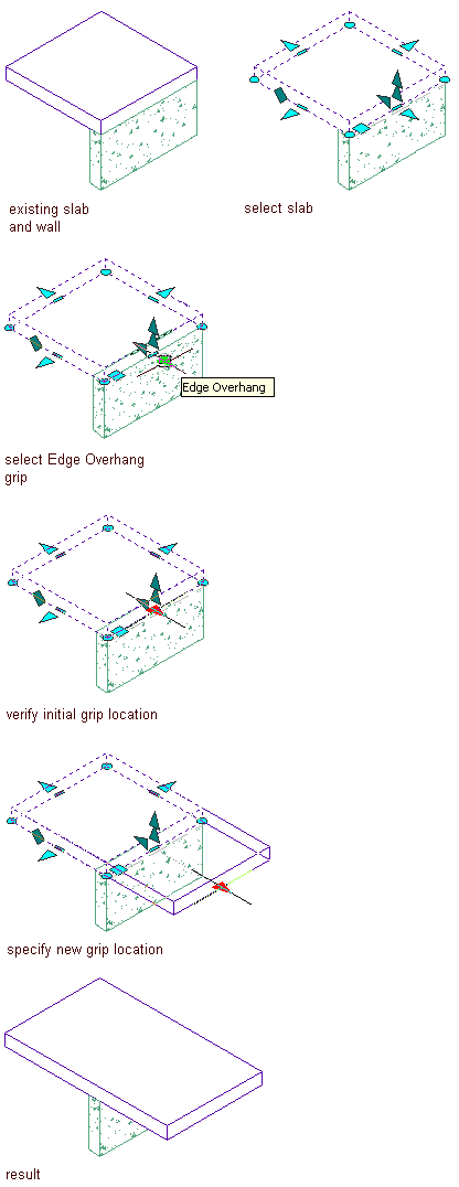

Use this procedure to change the overhang of a slab or roof slab edge. (You can also change the overhang using the worksheet available from the object’s Properties palette or its contextual ribbon tab.)
Changing the edge overhang of a slab using the Edge Overhang grip
