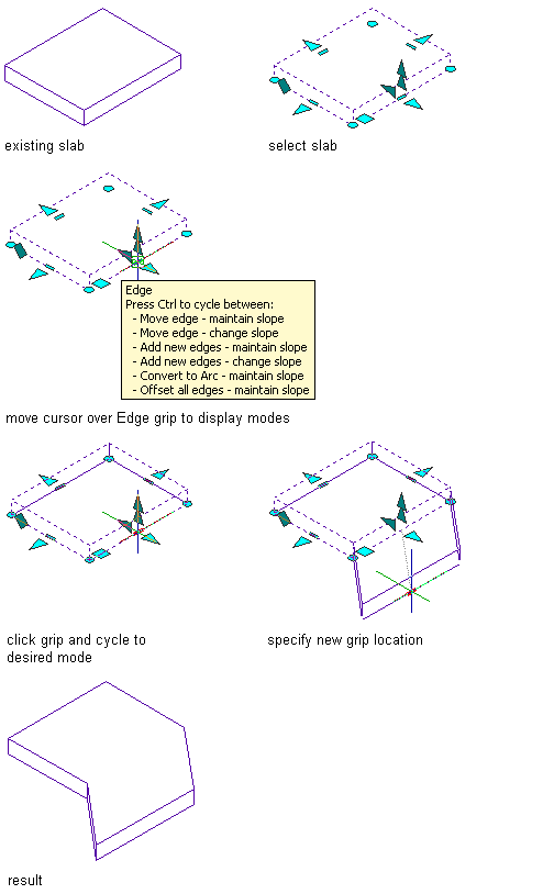

Normal grip editing maintains the slope angle of the slab or roof slab regardless of the Z value of the specified point.
Edge grips for straight slab or roof slab edges have the following 6 edit modes:
As you move the edge, adjacent edges stretch or shorten accordingly with no change to the slope. This is the default mode for straight edges.

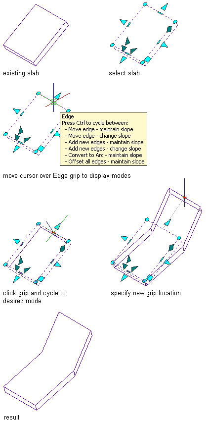

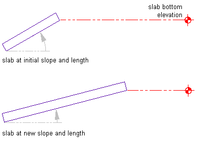

As you move the edge, adjacent edges stretch or shorten according to the direction of the move, and the slope changes as necessary to maintain the elevation of the edge being moved.
Side view

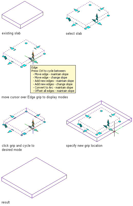

As you move the edge outward, rather than adjacent edges being stretched, new edges are added, each with its own Edge and Edge Overhang grips. There is no change to the slope.

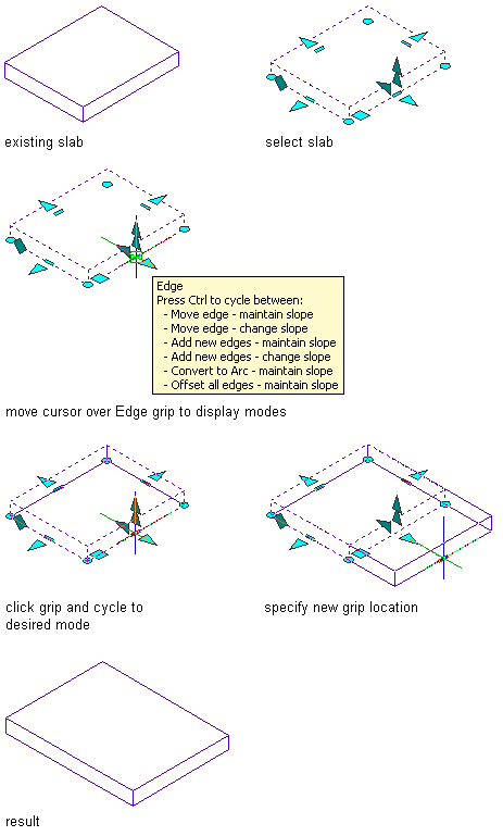

As you move the edge outward, rather than adjacent edges being stretched, new edges are added, each with its own Edge and Edge Overhang grips. The slope changes as necessary to maintain the elevation of the edge being moved.

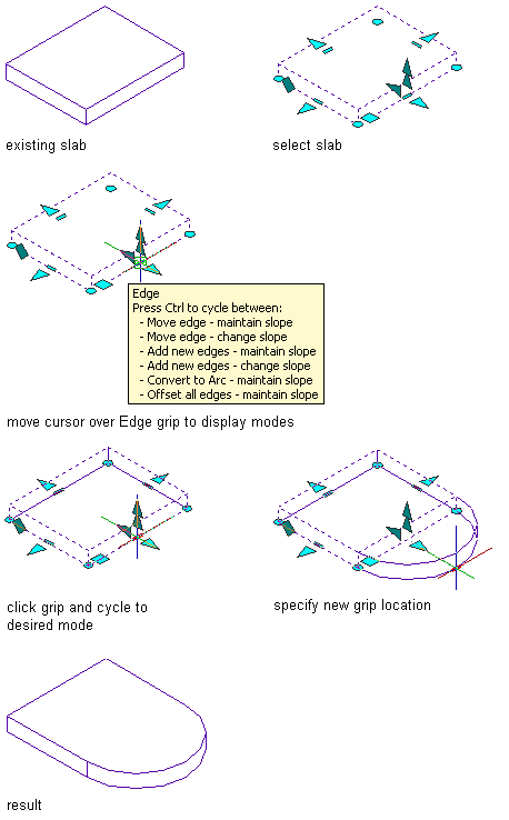

Converts the edge to an arc, which you can move inward or outward in the current plane to specify the arc direction and degree. Adjacent edges are not affected.

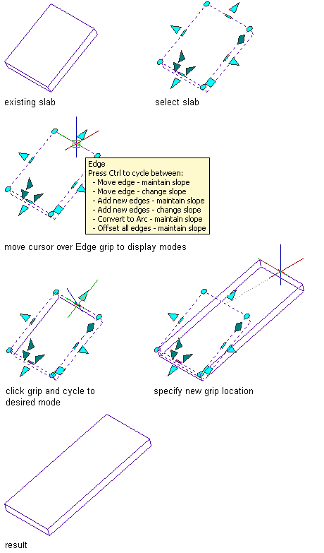

All outside perimeter edges move inward or outward in the current plane the same distance as you move the selected Edge grip. The degree of arc is maintained. If holes have been added to the slab or roof slab, their edges are unaffected.
