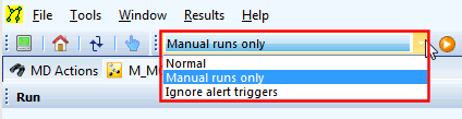

| Edit manifest mode of operation |

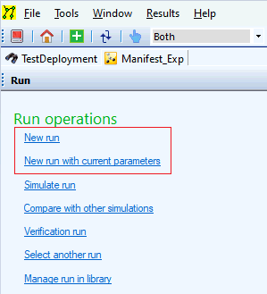

| Generate manual runs in the Operator Client |

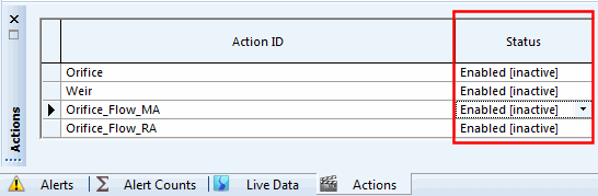

| Modify action status |
