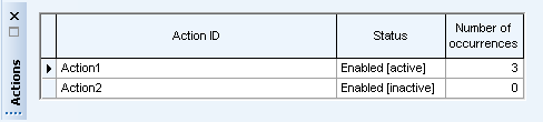

The Actions window contains a grid of the actions relevant to the simulation currently displayed in the Network page. The window is displayed in the middle of the Network Page beneath the GeoPlan Window.

| Field | Description |
| Action ID |
The name of the action. Action names are specified in the Action List set up in InfoWorks ICM Ultimate or ICMLive Configuration Manager. |
Status |
The current status of the action. This field may be edited by selecting an option from the dropdown list: Tip: Editing action statuses may be
permissioned in
ICMLive Configuration Manager and therefore will not be available to
ICMLive Operator Client users who have not been granted rights to perform this operation.
Tip:
Note that it is possible to turn action generation on or off for all the actions associated with a run by setting appropriately the Include actions run option of the Run Window. |
| Number of occurrences |
A counter of the number of times the action has been carried out when triggered by an alert occurring in consecutive simulations. This field is updated automatically. The maximum number of times the action will be carried out when triggered by an alert in consecutive simulations is set in the Action List. When a simulation is carried out in which the trigger alert does not occur, the counter will be set back to 0. |
