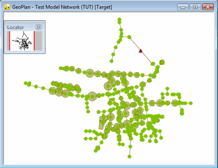

The following screenshot shows the factory default GeoPlan themes on a test network.

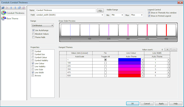

- Click Add (
) of the Sub Theme Manager Theme to add a new theme.
- Enter a new name for the theme, for example
Conduit thickness.
- Select
conduit_width (Width)
in the Field box.
- Click three consecutive times on the Plus button to add 3 intermediate values ("bins").
- Choose a Line Colour for the first and last values.
- Click Auto-Theme to generate a graduated set of colours for the intermediate values.

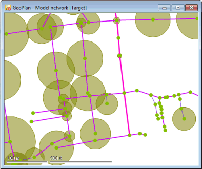

- In the Properties section, check Line Width in order to add this property to the Ranged Themes grid.
- Set a line width for the first and last value.
- Click Auto-Theme to populate the intermediate line widths.
- Click OK in the Layer Theme Editor to save the theme.
- Click OK to close the Layers and Themes page of the GeoPlan Properties dialog.
