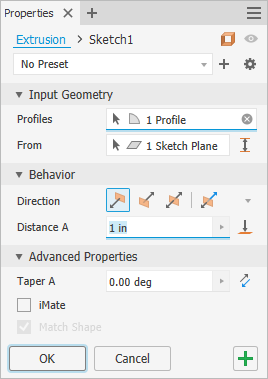

  1. On the ribbon, click 3D Model tab Create panel Extrude .
    If there is only one profile in the sketch, it is selected automatically. Otherwise, select a sketch profile.
  2. By default Extrude creates a solid body from an open or closed profile. You can also extrude a sketch as a surface body from an open or closed profile.
    At the top of the property panel is the breadcrumb. To the right of the breadcrumb select Surface mode . The selection determines the options presented in the property panel. The Surface mode state (ON/OFF) is saved with presets.
    Note: Surfaces function as a construction surface on which to terminate other features, or a split tool to create a split part, or split a part into multiple bodies. Surface selection is not available for assembly extrusions or primitives.

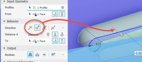

    • From - As the default, the extrusion starts from the sketch plane. To change the selection, in the From field, click the 'x' to clear the selection and choose a different starting plane. Work planes, sketch planes, and planar faces are valid input.
      • Between - use when extruding a shape between two faces. Select From and To faces, then select the Output type. The sketch doesn't have to be on either face.
        Note: If the solution isn't what you were looking for with the Default direction, click Flipped direction and toggle Alternate Solution to see additional solutions.
      • Extend face to end feature - automatically activates when the From selection does not intersect the extruded profile. You can also manually turn on or off the option. To turn the option off, click . The following is an example for how From and To are used together:

    • Direction: Default - Extrudes in one direction only. The extrusion end face is parallel to the sketch plane.
    • Flipped Direction - Extrudes in the direction opposite of Direction.
    • Symmetric - Extrudes in opposite directions from the sketch plane, using half the specified Distance A value in each direction.
    • Asymmetric - Extrudes in opposite directions from the sketch plane using two values, Distance A and Distance B. Enter a value for each distance. Click to invert the extrude direction using the specified values.

  6. In the Advanced Properties section you can specify additional options.
    • Taper A - sets a taper angle from 0 to 180 degrees normal to the sketch plane. The taper extends equally in both directions.
      Note: The in-canvas controls activate when the property panel edit field is clicked into.
      A positive taper angle increases section area along the extrusion vector:
      A negative taper angle decreases section area along the extrusion vector:
      When used with adjacent regions, taper will merge and blend faces to create a single feature.
    • iMate - Places an iMate on a closed loop such as an extruded cylinder, revolved feature, or hole. Autodesk Inventor attempts to place the iMate on the closed loop most likely to be useful. In most cases, place only one or two iMates per part.
    • Match Shape - If you select an open profile in a part file, specify whether you want to Match Shape and, if so, select the side to keep.
      If selected, Match Shape creates a flood-fill type operation. The open ends of the profile extend to a coedge, or face. The required faces quilt together to form a complete intersection with the extruded body.
      When deselected, the open profile closes by extending the open ends of the profile to the part. It closes the gap between them by including edges defined by the intersection of the sketch plane and the part. Creates the extrusion as if you specified a closed profile.
  7. Click OK or (Create new feature) to continue defining revolved features.

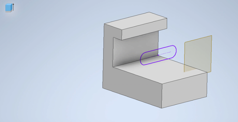

Create an extrusion terminating at a distance from a face
The profile sketch does not have to lie on the originating plane for the extrusion.
  1. Click 3D Model tab Create panel Extrude .
  2. If there is only one profile in the sketch, it is selected automatically. Otherwise, select a sketch profile.
  3. Select the face, work plane, or surface from which to start the extrusion. The option Extend face to end feature automatically activates when the From selection does not intersect the extruded profile. You can manually change the option.
  4. Specify the Behavior options, which could be direction and distance, to another face, and so on. Based on the selection the Terminate feature by extending the face option may be turned on. If the solution is ambiguous, such as when terminating to a curved surface, try applying the Alternate Solution option.
    Note: When working with a multi-body solid, you will need to specify the extrusion as part of another body by activating the Solid(s) selector and clicking the desired body or as a new body.
  5. Click OK or (Create new feature) to continue defining revolved features.
