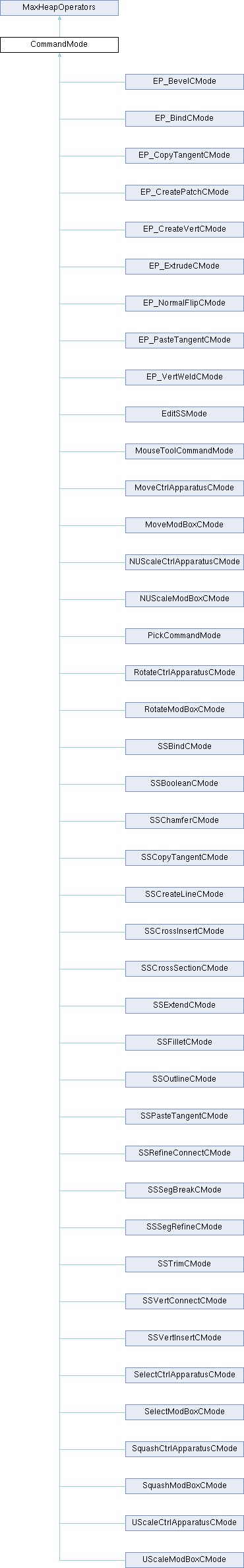

This base class allows the developer to create a command mode that handles processing user interaction using the mouse in the viewports.
See the page on "Command Modes and Mouse Procs" and "Foreground / Background Planes". There are methods in 3ds Max's Interface class to set and get the current command mode.
