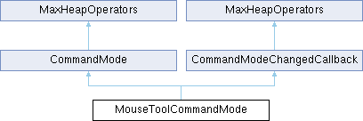

Inheritance diagram for MouseToolCommandMode:

Public Member Functions inherited from CommandMode
virtual ~CommandMode ()
 Destructor.
virtual int SuperClass ()
 This method can be ignored.
Public Member Functions inherited from CommandModeChangedCallback
virtual ~CommandModeChangedCallback ()
