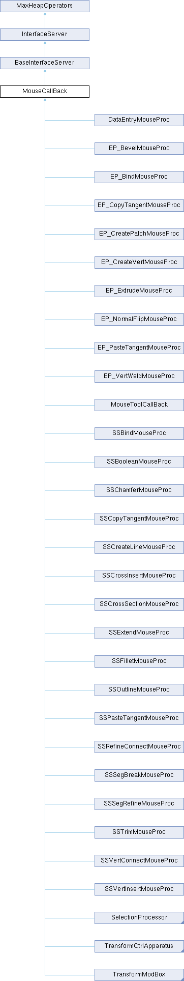

Inheritance diagram for MouseCallBack:

Reimplemented in DataEntryMouseProc, EP_BevelMouseProc, EP_BindMouseProc, EP_CopyTangentMouseProc, EP_CreatePatchMouseProc, EP_CreateVertMouseProc, EP_ExtrudeMouseProc, EP_NormalFlipMouseProc, EP_PasteTangentMouseProc, EP_VertWeldMouseProc, MouseToolCallBack, SelectionProcessor, SSBindMouseProc, SSBooleanMouseProc, SSChamferMouseProc, SSCopyTangentMouseProc, SSCreateLineMouseProc, SSCrossInsertMouseProc, SSCrossSectionMouseProc, SSExtendMouseProc, SSFilletMouseProc, SSOutlineMouseProc, SSPasteTangentMouseProc, SSRefineConnectMouseProc, SSSegBreakMouseProc, SSSegRefineMouseProc, SSTrimMouseProc, SSVertConnectMouseProc, SSVertInsertMouseProc, TransformCtrlApparatus, and TransformModBox.

Reimplemented in SSBooleanMouseProc, SSCreateLineMouseProc, SSCrossSectionMouseProc, SSExtendMouseProc, SSTrimMouseProc, and SSVertInsertMouseProc.
