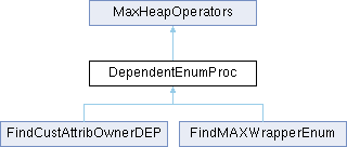

Inheritance diagram for DependentEnumProc:
