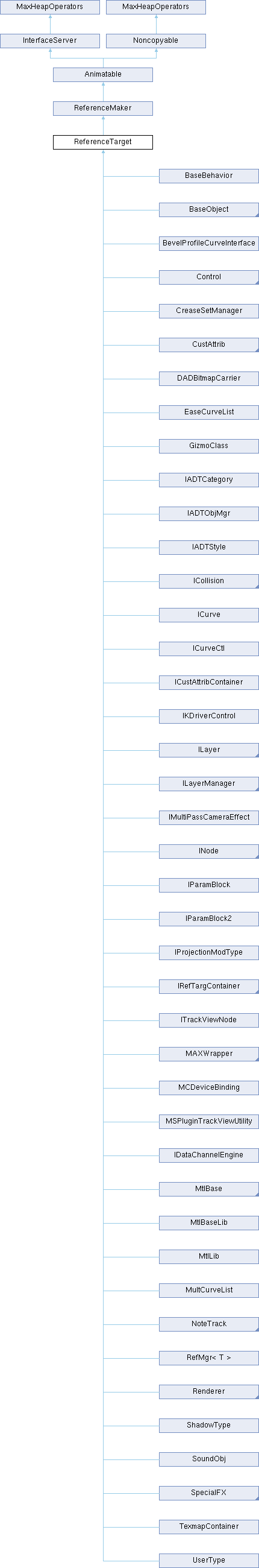

Inheritance diagram for ReferenceTarget:
