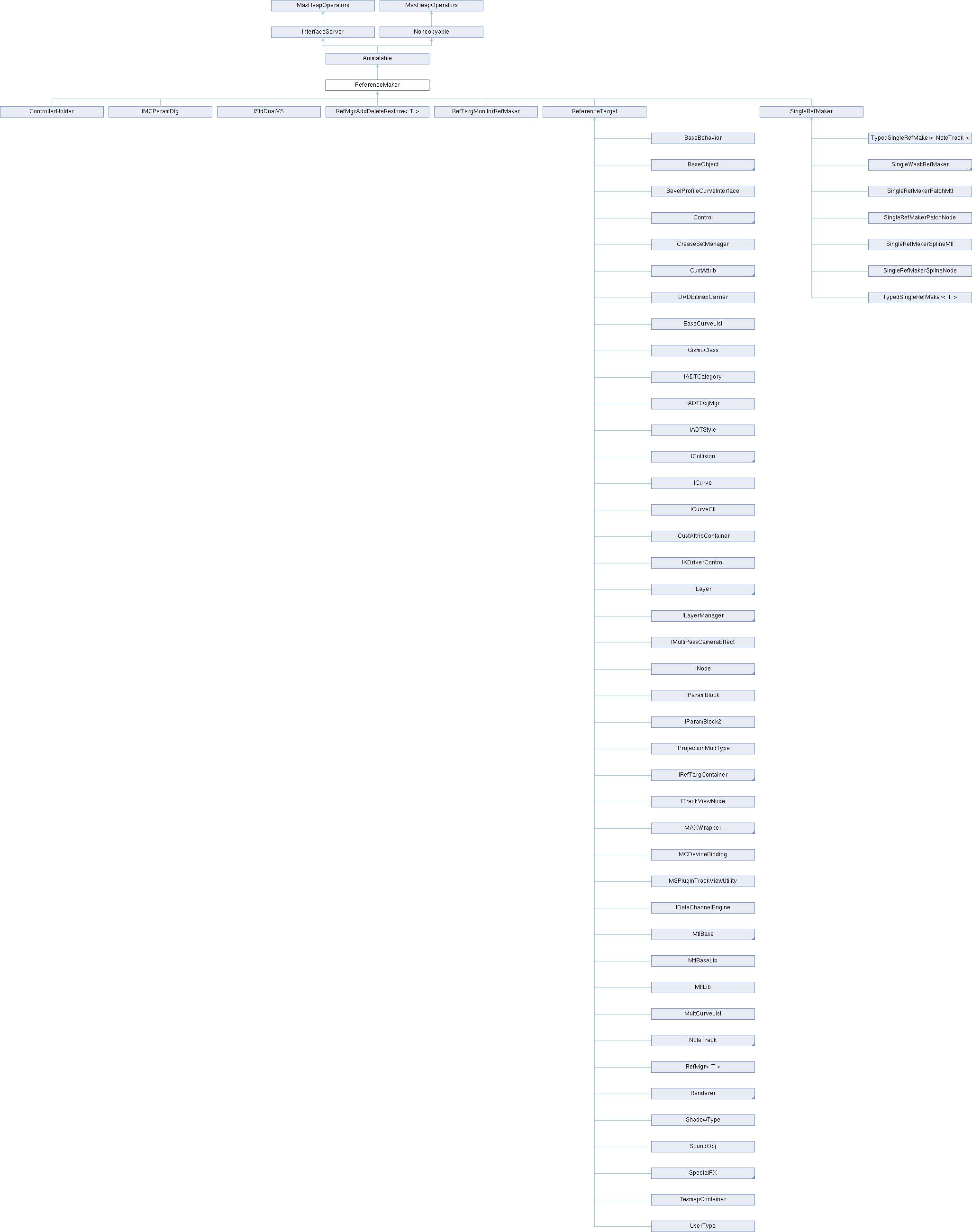

ReferenceMaker Class Referenceabstract
A scene entity that owns other scene entities and listens to messages from them. More...
#include <C:/adskgit/3dsmax/3dsmax/3dswin/src/maxsdk/include/ref.h>
Inheritance diagram for ReferenceMaker:
