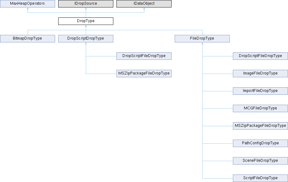

Detailed Description
See also
Class DropClipFormat, Class FileDropType, Class DropScriptDropType, DropTypes
Description:
This is the base class for droppable content types. Distinguished instances of subclasses represent different types of drop content, such as a file distinguished by file suffix or a scene object The active DropClipFormat parses dropped IDataObject into one of these dropped types, filling its data members with appropriate guff from the data object.
Each DropClipFormat can encompass multiple possible types of dropped data. For example, the iDrop package can drop max files, image files, script files, etc. The DropClipFormat classes parse raw dropped clipboard data into one of the DropType family of classes. These contain recognizer predicates, extracted data from the current drop, and utilities for working with the data, such as URL downloads, script compile & execution, etc. Custom drop-types can be created by subclassing one of the DropType base classes. The built-in DropTypes are listed in DropTypes
Data Members:
protected:
static IDragAndDropMgr* dndMgr;
Cached pointer to the drag and drop manager.
static bool dragging;
The drop source state.
static POINT startPt;
The drag and drop starting point.
static WPARAM startKeyState;
They starting state of the keyboard.
static HWND startWnd;
The handle to the starting window.
static bool loaded;
Flags if the current packages is already downloaded.
static IDataObject* current_dataobject;
Currently dropping IDataObject. Filled in by the low-level DragEnter() code.
◆ DropType()
DropType ( )
inline
Remarks
Constructor.
790{ if (dndMgr == NULL) dndMgr = GetDragAndDropMgr(); }
