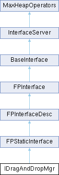

Inheritance diagram for IDragAndDropMgr:
