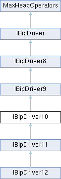

IBipDriver10 Class Referenceabstract
Interface into the biped driver controller for Max 10. More...
#include <C:/adskgit/3dsmax/3dsmax/3dswin/src/maxsdk/include/CS/Biped10Api.h>
Inheritance diagram for IBipDriver10:
