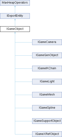

Inheritance diagram for IGameObject:

Simple wrapper for 3ds Max objects.
This is heart of the interaction with 3ds Max objects. 3ds Max objects are converted to IGame objects to provide simpler interfaces. Specific support is given to Meshes, Splines, Helper (including bones) and Cameras. Any object that is not supported by IGame directly is supported as a generic object, so that properties can be extracted easily. At the present time IGame only supports Geom Objects that can be converted to a Tri Object.
A note about XRef items. IGame will search out XRef Objects and store them as IGameXrefObject. External file names and proxies can be accessed by casting IGameObject* to IGameXrefObject*
Some of the interfaces returned by IGameObject require that the nodes be parsed by IGame first.
See also
IGameNode, IGameMesh, IGameLight, IGameCamera, IGameSupportObject
IExportEntity
