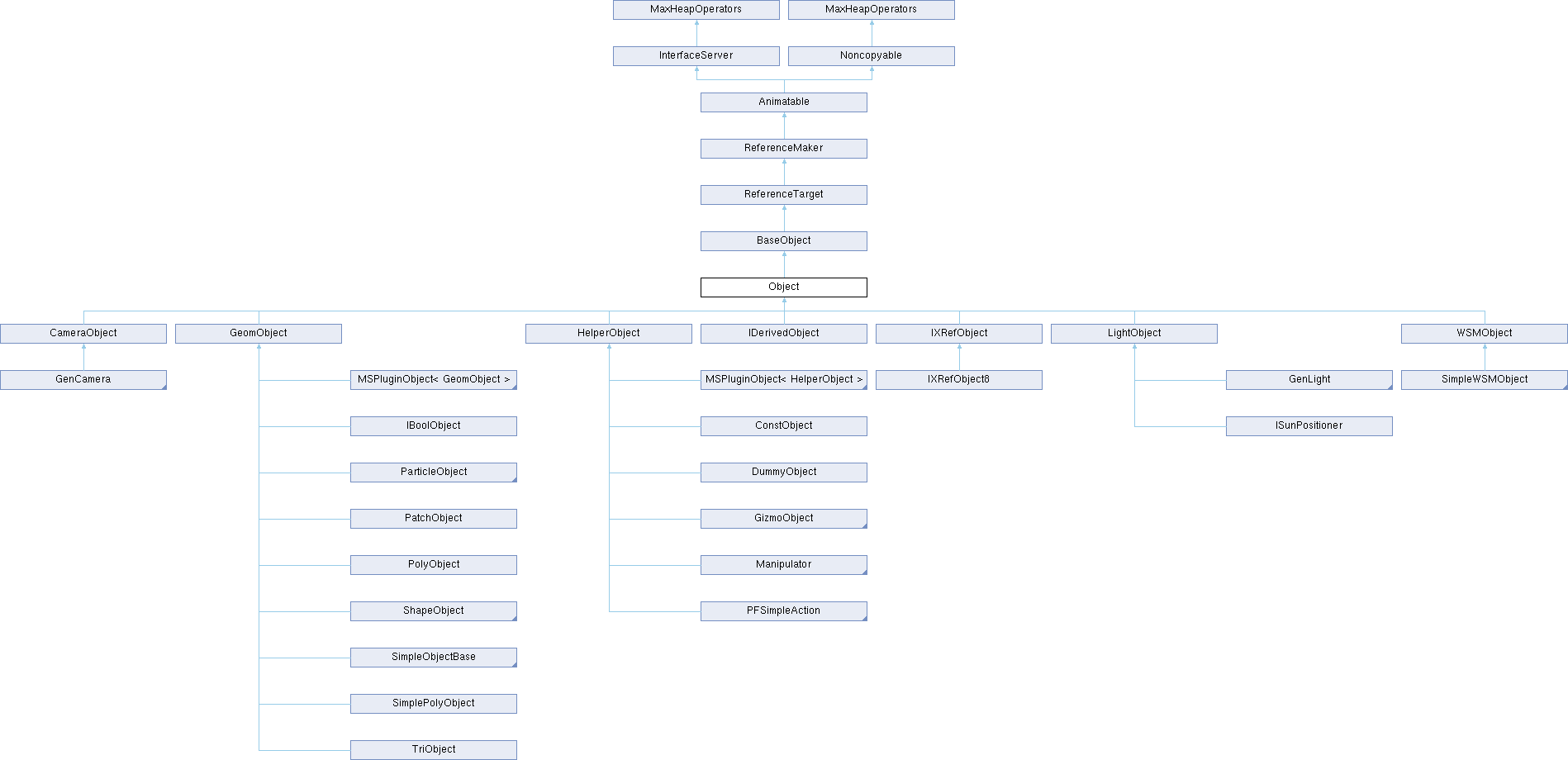

Object Class Referenceabstract
The object class is the base class for all objects. More...
#include <C:/adskgit/3dsmax/3dsmax/3dswin/src/maxsdk/include/object.h>
Inheritance diagram for Object:
