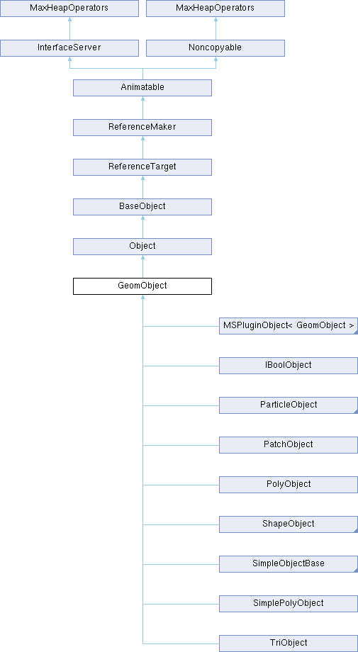

3ds Max C++ API Reference
This is the base class for the creation of Geometric Object plug-ins. More...
This class represents an object that has geometry and is renderable.
