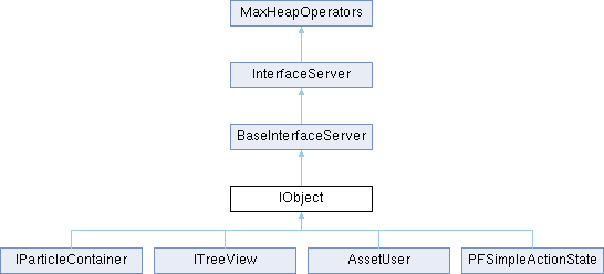

Inheritance diagram for IObject:

Detailed Description
See also
Class BaseInterfaceServer, Class FPInterface, Class FPInterfaceDesc, ~{ Function Publishing }~, Class InterfaceServer,
Description:
This is the base class used to publish functions from those objects not derived from Animatable. A developer inherits from this class and implements the methods of this class to provide information about the interfaces published by the class.
There is a corresponding ParamType2 type code, TYPE_IOBJECT, that allows instances of these classes to be passed and returned in FPInterface methods. This provides a simple form of user-defined type, in the sense that these instance collections are passed as interfaces rather than pointers. MAXScript has wrapper value classes for IObjects and so this mechanism provides a light-weight alternative to the MAXScript SDK facilities for adding new wrapper value classes to the scripter.
MAXScript also calls the AcquireInterface() and ReleaseInterface() methods on IObjects as it creates and collects these wrappers, so that IObject objects can keep track of MAXScript's extant references to them.
Example
Member Function Documentation
◆ GetIObjectName()
virtual const MCHAR * GetIObjectName ( )
inlinevirtual
Remarks
Returns the object/class name.
Default Implementation:
{ return _M(""); }
Reimplemented in ITreeView, and AssetUser.
