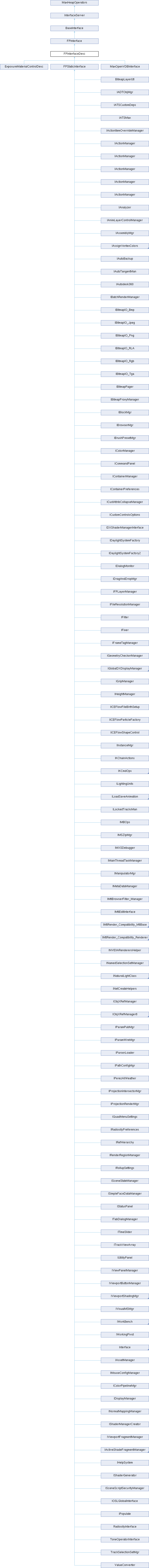

Inheritance diagram for FPInterfaceDesc:
