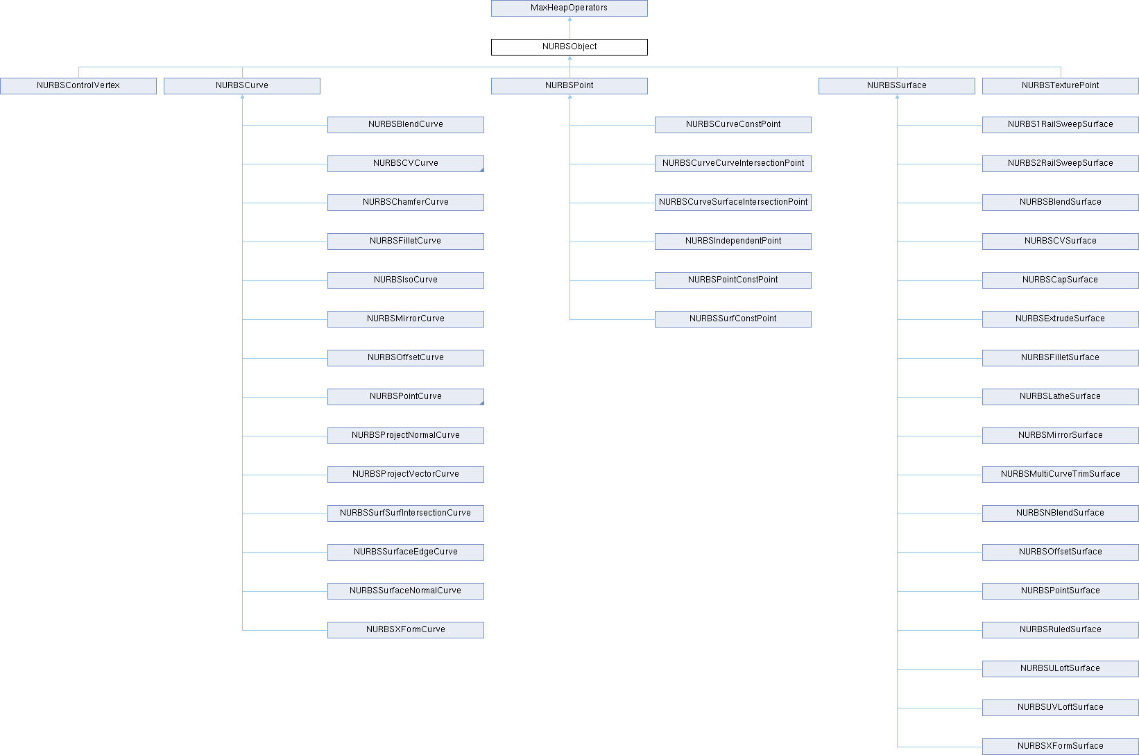

Inheritance diagram for NURBSObject:

Detailed Description
See also
Class NURBSSurface, Class NURBSControlVertex, Class NURBSPoint, Class NURBSCurve, Class NURBSSet, NURBSObject Types
Description:
This is the base class for many of the other classes in the NURBS API. It provides a common set of methods that each of them use. It has methods to get and set the name of the item, and methods to deal with error processing. To determine the type of object the derived class is use the method GetType().
All methods of this class are implemented by the system.
