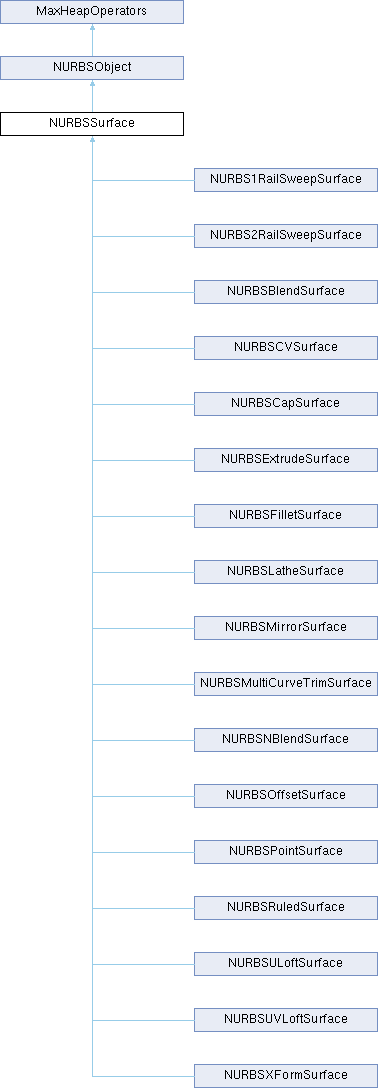

Inheritance diagram for NURBSSurface:

Detailed Description
See also
Class NURBSObject, Class NURBSTextureSurface, Template Class Tab, Class NURBSTextureChannelSet.
Description:
This class describes the properties of a NURBS surface. This includes its material ID, texture/tiling options, renderable state, open/closed state, and normal inverted state. The Evaluate() method is used to compute points and tangents on the surface.
All methods of this class are implemented by the system.
