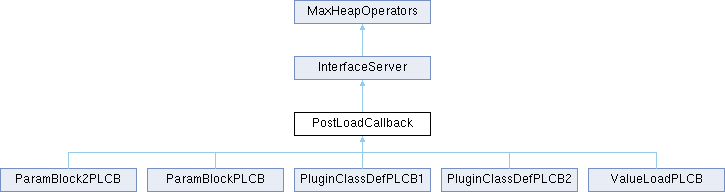

Inheritance diagram for PostLoadCallback:
