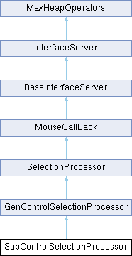

Inheritance diagram for SubControlSelectionProcessor:
