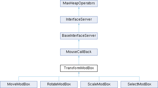

Inheritance diagram for TransformModBox:
