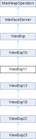

Public Member Functions | |
| virtual | ~ViewExp11 () |
| Destructor. | |
Adaptive Degradation parameters | |
| virtual BOOL | IsDegrading ()=0 |
| Gets whether or not we are in the process of drawing the viewports in an degraded state. | |
| Public Member Functions inherited from ViewExp10 | |

| Public Member Functions inherited from ViewExp | |

| Public Member Functions inherited from InterfaceServer | |

Extends ViewExp10.
The following code example shows how to get access to this interface:
