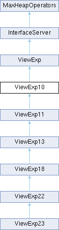

ViewExp10 Class Referenceabstract
Extends ViewExp. More...
#include <C:/adskgit/3dsmax/3dsmax/3dswin/src/maxsdk/include/maxapi.h>
Inheritance diagram for ViewExp10:
