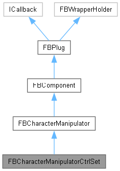

Constraint class. More...
#include <fbcharactermanipulator.h>
