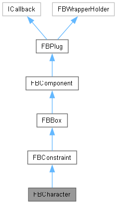

Inheritance diagram for FBCharacter:

virtual bool FbxStore (FBFbxObject *pFbxObject, kFbxObjectStore pStoreWhat)
 Storage/Retrieval of information into the FBX file format.
virtual bool FbxRetrieve (FBFbxObject *pFbxObject, kFbxObjectStore pStoreWhat)
virtual bool AnimationNodeDestroy (FBAnimationNode *pAnimationNode)
 Destroy an animation node.
virtual bool AnimationNodeIsUserData (FBAnimationNode *pAnimationNode)
 Is the animation node user data?
virtual void AnimationNodesOutDisableIfNotWritten (FBEvaluateInfo *pEvaluateInfo)
 This call will disable all out animation nodes from being pull by system (animation thread) for given pEvaluateInfo.
virtual FBAnimationNodeAnimationNodeInGet ()
 Get the (IN/OUT) animation node for this box.
virtual FBAnimationNodeAnimationNodeOutGet ()
virtual const char * FbxGetObjectType ()
 Returns the class type inherited by the class of an object, for example: 'Box', 'Constraint', 'TimelineXTrack'.
virtual const char * FbxGetObjectSubType ()
 Returns the class sub type inherited by the class of an object, for example: 'Relations', 'Parent-Child', 'Number to Vector', 'Shot'.
 IObject_Declare (override)
virtual int GetOutConnectorCount () const
 Get the number of animation node outputs for this box.
virtual int GetInConnectorCount () const
 Get the number of animation node inputs for this box.
virtual FBAnimationNodeGetOutConnector (int pIndex) const
 Get the animation node output associated with the given index.
virtual FBAnimationNodeGetInConnector (int pIndex) const
 Get the animation node input associated with the given index.
