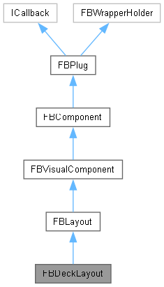

Deck layout class. More...
#include <fbdecklayout.h>

Deck layout class.
Definition at line 106 of file fbdecklayout.h.
