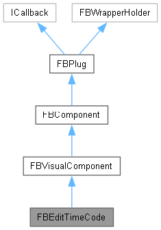

Definition at line 1788 of file fbcontrols.h.
| FBEditTimeCode | ( | ) |
Constructor.
| FBPropertyEvent OnChange |
Event: Timecode changed.
Definition at line 1797 of file fbcontrols.h.
| FBPropertyTime Value |
Read Write Property: Current timecode value.
Definition at line 1795 of file fbcontrols.h.
