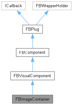

Image. More...
#include <fbcontrols.h>
Public Member Functions | |
| FBImageContainer () | |
| Constructor. | |

Image.
Definition at line 1238 of file fbcontrols.h.
| FBImageContainer | ( | ) |
Constructor.
| FBPropertyString Filename |
Read Write Property: Filename for image.
Definition at line 1244 of file fbcontrols.h.
| FBPropertyEvent OnDragAndDrop |
Event: Drag and drop.
Definition at line 1247 of file fbcontrols.h.
| FBPropertyBool UseTransparentBackground |
Read Write Property: True to specify that the image is using a transparent background, false otherwise.
Definition at line 1245 of file fbcontrols.h.
