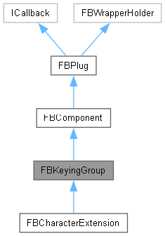

KeyingGroup class. More...
#include <fbkeyinggroup.h>

KeyingGroup class.
This class is an interface to manipulate which properties will be keyed when active. A derived class could control when the keying group should activate and what content it should have. For example, a derived class could activate based one that is selected in the scene.
To create a custom keying group, use the appropriate FBKeyingGroupType flag. Then, if it is a local keying group, call AddObjectDependency() to add an object to the keying group. You can then add properties belonging to the new object with AddProperty().
If you are creating an object type keying group, call SetObjectType() to specify what kind of object will be keyed by this keying group. Then, add a property from an object, the name of the property will be used by the keying group the find corresponding properties in selected object.
If you create a global keying group, simply properties from an object with AddProperty(). The name of the property will be used by the keying group to find corresponding properties in the selected object.
Definition at line 87 of file fbkeyinggroup.h.
