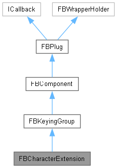

Objects Grouping class. More...
#include <fbcharacterextension.h>
