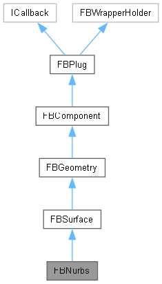

Nurbs class. More...

Public Member Functions inherited from FBSurface | |

Public Member Functions inherited from FBGeometry | |

Public Member Functions inherited from FBComponent | |

Nurbs class.
Definition at line 869 of file fbgeometry.h.
