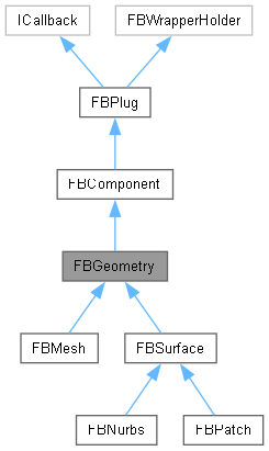

Geometry class. More...
#include <fbgeometry.h>
