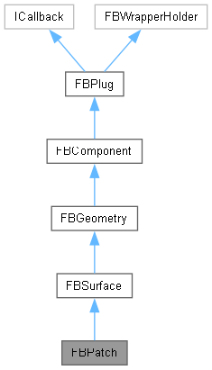

Patch class. More...
#include <fbgeometry.h>

Patch class.
Definition at line 953 of file fbgeometry.h.
