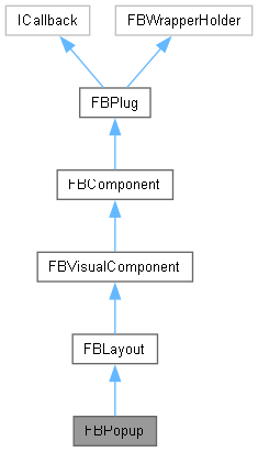

Popup window. More...
#include <fbcontrols.h>

Popup window.
This class lets a window (inheriting from FBLayout) be created for another interface.
Definition at line 2052 of file fbcontrols.h.
| FBPopup | ( | ) |
Constructor.
virtual |
Close popup.
| pOk | Equivalent of OK button clicked if true (default = false). |
virtual |
Show popup.
| pParent | Parent object for popup |
| FBPropertyString Caption |
Read Write Property: Caption to display in popup.
Definition at line 2070 of file fbcontrols.h.
| FBPropertyBool Modal |
Read Write Property: Modal?
Definition at line 2071 of file fbcontrols.h.
