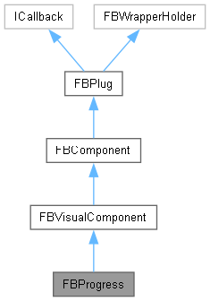

Progress bar. More...
#include <fbcontrols.h>
Public Member Functions | |
| FBProgress () | |
| Constructor. | |
| void | ProgressBegin () |
| Start progress, must be called before set Text & Percent property. | |
| void | ProgressDone () |
| End progress, must be called to reset progress bar UI to normal status after finishing the task. | |
| bool | UserRequestCancell () |
| Return true if User is pressing and holding "ESC" key to request the cancellation. | |

Progress bar.
Definition at line 2020 of file fbcontrols.h.
| FBProgress | ( | ) |
Constructor.
| void ProgressBegin | ( | ) |
| void ProgressDone | ( | ) |
| bool UserRequestCancell | ( | ) |
Must be called in between ProgressBegin()/ProgressDone().
| FBPropertyString Caption |
Read Write Property: Caption to be displayed for progress bar.
Definition at line 2039 of file fbcontrols.h.
| FBPropertyInt Percent |
Read Write Property: Percent completed for the operation. Must be used called in between ProgressBegin()/ProgressDone()
Definition at line 2041 of file fbcontrols.h.
| FBPropertyString Text |
Read Write Property: Text to display on progress bar. Must be used in between ProgressBegin()/ProgressDone()
Definition at line 2040 of file fbcontrols.h.
