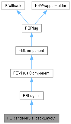

RendererCallback layout class. More...
#include <fbrenderercallbacklayout.h>
Definition at line 108 of file fbrenderercallbacklayout.h.
| FBRendererCallbackLayout | ( | FBRendererCallback * | pRendererCallback = NULL | ) |
Constructor.
| pRendererCallback | RendererCallback to association with RendererCallback layout. |
| FBPropertyRendererCallback RendererCallback |
Property : RendererCallback.
Definition at line 118 of file fbrenderercallbacklayout.h.
