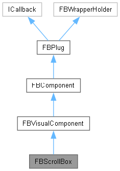

Scroll Box. More...
#include <fbcontrols.h>
Public Member Functions | |
| FBScrollBox () | |
| Constructor. | |
| void | SetContentWidth (int pContentWidth) |
| Sets the content width. | |
| void | SetContentHeight (int pContentHeight) |
| Sets the content height. | |
| FBLayout * | GetContent () |
| Returns an empty layout in which you can add scrollable content. | |

Scroll Box.
This class provides a layout that will be automatically managed with a scrollbar according to the specified width and height. This provides a way to add dynamic UI control.
Definition at line 1177 of file fbcontrols.h.
