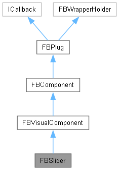

Slider.
Definition at line 1406 of file fbcontrols.h.
| FBSlider | ( | ) |
Constructor.
| FBPropertyDouble LargeStep |
Read Write Property: Large step value.
Definition at line 1416 of file fbcontrols.h.
| FBPropertyDouble Max |
Read Write Property: Maximum value.
Definition at line 1413 of file fbcontrols.h.
| FBPropertyDouble Min |
Read Write Property: Minimum value.
Definition at line 1412 of file fbcontrols.h.
| FBPropertyEvent OnChange |
Event: Slider value changed.
Definition at line 1419 of file fbcontrols.h.
| FBPropertyEvent OnTransaction |
Event: Transaction begin/end (continuous value changes). This event property doesn't exist in pyfbsdk.
Definition at line 1420 of file fbcontrols.h.
| FBPropertyOrientation Orientation |
Read Write Property: Slider orientation.
Definition at line 1415 of file fbcontrols.h.
| FBPropertyDouble SmallStep |
Read Write Property: Small step value.
Definition at line 1417 of file fbcontrols.h.
| FBPropertyDouble Value |
Read Write Property: Current value.
Definition at line 1414 of file fbcontrols.h.
