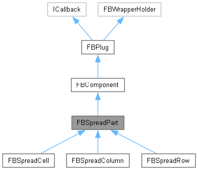

Spreadsheet part. More...
#include <fbcontrols.h>
Public Member Functions | |
| FBSpread * | GetSpread () |
| Returns the Spread control this part belongs to. | |

Spreadsheet part.
Definition at line 1485 of file fbcontrols.h.
protected |
Constructor.
| pParent | Parent Spreadsheet. |
